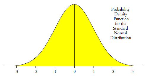

So let us define the invisible portion of a probability model as the most extreme part per thousand in each infinite tail. For the standard normal distribution this definition results in a visible portion that ranges from –3.09 to 3.09 and which contains 0.998 of the total area. This is why accurate representations of a normal distribution result in a visual portion that falls within 3.1 standard deviations on either side of the mean.
Figure 2: A standard normal distribution

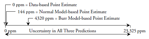

But how much uncertainty should be attached to these model-based predictions? As soon as we ask this question we run into a fact of life: The uncertainty for the model-based predictions cannot be less than the uncertainty for the data-based prediction. We cannot reduce our uncertainty by fitting an assumed model to our data—the uncertainty of the assumption can only add to the uncertainty inherent in the data. We simply cannot leverage our 200 data into supporting parts-per-million computations by fitting some probability model to those data.
So, using a normal probability model, our prediction is 144 parts per million with an interval estimate of zero to 23,325 parts per million!
Using the Burr model of figure 1 our prediction is 4,320 parts per million with an interval estimate of zero to 23,325 parts per million!
Using our data-based prediction our estimate is zero, with an interval estimate of zero to 2.3 percent nonconforming.
Given the uncertainty of zero to 2.3 percent, the three point estimates of zero, 144 ppm, and 4,320 ppm are simply three estimates of the same thing!
Figure 3: Estimating the fraction nonconforming
As long as we are working with the homogeneous data set of 200 values, our interval estimate of the fraction nonconforming will remain “something less than 2.3 percent nonconforming.” And this will remain true regardless of how many mathematical gyrations we may use in obtaining our point estimate. While the probability models allow us to compute numbers that seem more precise and exact than what we get from our data-based prediction, all this supposed precision and exactness is nothing more than smoke and mirrors that serve to distract the statistically naive.

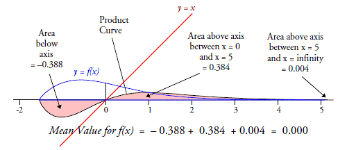

For a continuous probability model, f(x), the mean value is defined by the area between the x-axis and a curve. This curve is called the product curve. It consists of the set of points that result when we multiply x by f(x) for all values of x. This area between the product curve and the horizontal axis is shaded in figure 4. The visible portion of this Burr distribution extends from –1.55 to +5.0, and the invisible portion extends from 5.0 to infinity.
Figure 4: Computing the mean value for the Burr distribution in figure 1
To discover the relationship between the visible portion of the distribution and the mean value we will ignore the negative sign for the area below the axis and simply add up all of the areas between the product curve and the axis. Here we get 0.388 + 0.384 + 0.004 = 0.776. Of this total area, 0.772 comes from the visible portion of this distribution, and 0.004 comes from the invisible portion. Hence, the visible portion of this distribution accounts for 0.772/0.776 = 0.995 or 99.5 percent of the mean value parameter, and the most extreme part-per-thousand of this probability model (the invisible portion) accounts for one-half percent of the area used to determine the mean value. Thus, the mean value is primarily dependent upon the visible portion of this distribution.

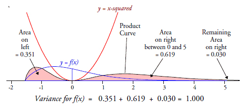

When a probability model, f(x), has a mean value of zero we may define the variance of that model as the area between the x-axis and the product curve obtained by multiplying x-squared and f(x). For the Burr distribution given in figure 1 this area between the product curve and the horizontal axis is shaded in figure 5.
Figure 5: Computing the variance for the Burr distribution in figure 1
The sum of the areas between the product curve and the axis is 1.000, which is the variance for this probability model. Here we find that 97 percent of the total area comes from the visible portion of the distribution and 3 percent comes from the invisible portion. Thus, the variance is primarily dependent upon the visible portion of this distribution.

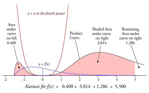

When a probability model, f(x), has a mean value of zero and a variance of one, the kurtosis of that model may be generically defined as the area between the x-axis and the product curve obtained by multiplying x-to-the-fourth-power and f(x). This area is shaded in figure 7 (for the visible portion of the Burr distribution).
Figure 7: Computing the kurtosis for the Burr distribution in figure 1
The kurtosis for this distribution is 5.500. Of the area used to compute this value only 4.214 or 76.6 percent came from the visible portion of this distribution. The last part per thousand of this distribution (the invisible portion) contributed 23.4 percent of the area used to determine the kurtosis parameter!

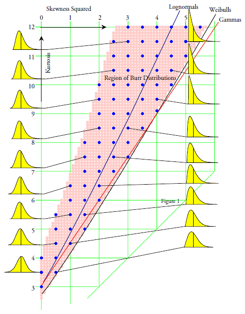

To generalize the results above I looked at the parameters for the 73 standardized Burr distributions represented by the dark dots in figure 8. (The probability models are shown for 18 of these 73 distributions to help the reader to understand the wide range of shapes included in this set.)
Figure 8: 73 Burr distributions on the shape characterization plane
For each of these 73 models I computed the contributions of the visible portion to the computation of the mean, the variance, the skewness, and the kurtosis parameters. The table in figure 9 summarizes these results for each parameter. For each set of 73 percentages, figure 9 gives the minimum, average, and maximum contributions attributable to the visible portion of the distributions.
