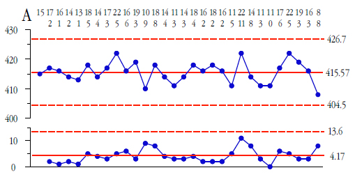

In order to evaluate a measurement system, we will need some sort of study where multiple determinations are made of the same thing or the same group of things. Perhaps the simplest form for studies of this sort is to measure the same thing repeatedly. When these values are placed on an XmR chart we end up with a test for the consistency of the measurement system. Figure 1 shows the consistency chart for 30 determinations of a standard using instrument A. (The readings shown on the chart have been coded by subtracting 400 from each observation.)
Figure 1: Consistency chart for 30 repeated measurements of a single standard with Inst. A
Here we find all of the points within the limits. This is taken as evidence of a consistent measurement process. If any of the points on a consistency chart fall outside the limits they represent strong evidence that the measurement system is inconsistent.
Any attempt to characterize an inconsistent “measurement system,” or to compare it with other measurement systems, will be premature. (A measurement system that gives inconsistent results is not even equivalent to itself, so how can it ever be equivalent to another instrument?) All that follows is built on the assumption that each of the measurement systems being compared has already demonstrated its consistency by means of a consistency chart. For more about consistency charts see “Consistency Charts” by Donald J. Wheeler (QDD, March 27, 2013).

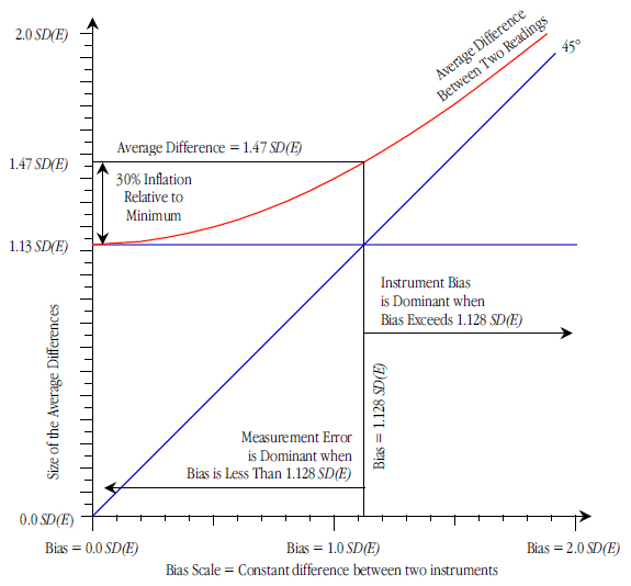

When one instrument has a bias relative to another, this bias will affect every reading made by the one instrument. This will, on the average, inflate the differences between the readings from the two instruments. In the absence of measurement error, the average difference between two readings of the same thing would be a linear function of the bias. Thus, the expected effect of instrument bias alone may be shown by the 45-degree line in figure 2.
Figure 2: The average difference between two readings

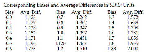

When we combine the effects of both bias and measurement error we find that the average difference between two readings of the same thing by two instruments will follow the curve in figure 2. The points that define the curve of figure 2 are tabled in figure 3.
Figure 3: Bias and corresponding average differences in SD(E) units
Figure 2 shows that there is a region where measurement error is the dominant effect and that there is a region where bias effects dominate. The crossover point between these two regions occurs at the point where the two straight lines cross. Here the bias is equal to 1.128 SD(E) and from figure 3 the average difference between pairs of readings by the two instruments will be 1.467 SD(E).
Figure 4: The averages between two readings
On the left side of figure 4, where the instrumental bias is less than 1.128 SD(E), the average distance between readings of the same thing using the two instruments will always be within 30 percent of the minimum value.
On the right side of figure 4, where the instrument bias exceeds 1.128 SD(E), the bias will begin to create a systematic difference between the measurements from the two instruments. Here the instruments will no longer be equivalent in practice.
So, our criterion for practical equivalence becomes one of having an instrumental bias that is smaller than 1.128 SD(E).

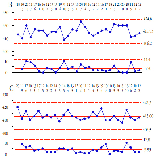

In figure 1 we have 30 determinations of the value of a standard with instrument A. Figure 5 shows the consistency charts for 30 determinations of the same standard using instruments B and C.
Figure 5: Consistency charts for 30 repeated measurements of a single standard with Inst. B and Inst. C
The average range for instrument B is 3.50 units, thus the probable error is estimated to be 2.1 units. The average range for instrument C is 3.93 units, giving a probable error of 2.4 units. Earlier we found a probable error of 2.5 units for instrument A. The similarity of these probable errors suggests that these three instruments can be considered to have equivalent amounts of measurement error. A way to test this idea will be given in next month’s column.

As we found earlier, the average difference between two readings made with the same instrument is 1.128 SD(E) = 3.9 units. Our detected instrumental bias of 2.5 units is smaller than this minimum average difference. We can use the table in figure 3 to characterize the effect of this bias. The estimated bias of 2.5 units is only 73 percent as large as the estimate of SD(E) = 3.446.
Interpolating in figure 3 we find that this bias corresponds to an average difference between a reading from instrument C and a reading from one of the other instruments of 1.274 SD(E)  =  4.4 units. Since these readings are recorded to whole numbers of units the instrumental bias will usually be lost in the round-off. (Two readings from the same instrument will differ by an average amount that rounds off to 4 units, while two readings from different instruments having a bias of 2.5 units will also differ by an average amount that rounds off to 4 units.

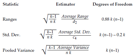

Common unbiased estimators of the standard deviation of the subgroup averages are given in figure 7 for data arranged into k subgroups of size n.
