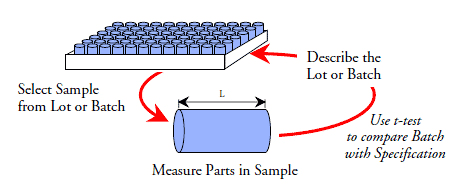

When we have a random sample, the uncertainty in the extrapolation from the sample to the lot may be characterized by the formulas of statistical inference. Descriptive statistics are taken as point estimates for the lot as a whole. Confidence intervals are used to define ranges of descriptive values that are logically consistent with the observed data. And tests can be used to determine if the lot meets some specification value. (This is the context in which Student’s t-test was developed—as a master brewer for Guinness, W. S. Gossett wanted to know how much to pay for shipments of hops, etc. As a shipment was unloaded periodic samples were obtained from throughout the shipment and these were tested to determine the average value for some characteristic of the ingredient.)
Figure 1: An enumerative study
Thus, in an enumerative study, if the sample has been obtained in a manner that is likely to make it representative of the lot, then the methods of statistical inference may be used to quantify the uncertainty in the extrapolation from the sample to the lot as a whole. And the action taken on the lot will depend upon two things: a judgment about the representativeness of the sample, and the outcome of the statistical inference.

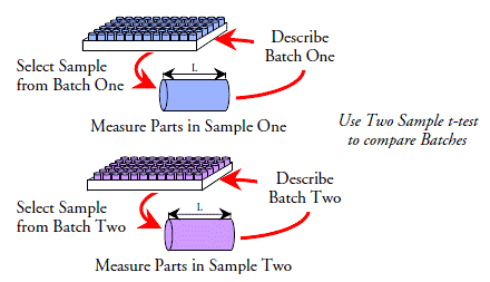

Gossett solved the simple enumerative problem when he gave us Student’s t-test. One of the next questions was “How can we compare two or more batches?” The two-sample t-test, and Sir Ronald Fisher’s generalization thereof, the F-test, were developed over the next 17 years.
Figure 2: Comparing two batches

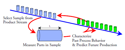

Since we cannot measure that which has not yet been made, the observations used in an analytic study are often the same as those used in an enumerative study. Nevertheless, the issues of prediction are different than those of description, and so our analysis will also need to be different.
The first difference involves how we interpret our data. For the purpose of prediction it matters not whether the data represent 100 percent of the product made or represent some fraction thereof. Moreover, since it is impossible to take a random sample from the future, in an analytic study all of our observations become a judgment sample regardless of how they were obtained. Here our extrapolation is over time, and so it is the temporal spread of our data that becomes our primary consideration. This places a premium on systematic methods of selecting items from the product stream (as opposed to the random sampling methods used in enumerative studies). Of course the data still have to be organized rationally. That is, we have to respect the structure and context of our data when we apply them to the problem of prediction. But it is the judgment about the rationality of the application of the data that is the basis for our degree of belief in the predictions made. This why analytic studies place an emphasis on rational sampling and rational subgrouping as opposed to the many different random sampling procedures developed for enumerative studies.

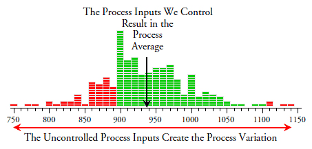

By choosing the levels for our control factors we try to operate our process average near the target value. By holding our control factors constant we prevent them from contributing to the variation in the product stream. Thus, control factors provide a way of adjusting the process average, but have little to no impact upon the process variation.
Virtually all of the process variation will come from the group of uncontrolled factors. To reduce the variation in the product stream, and thereby to reduce the excess costs of production and use, we shall have to move some process inputs from the set of uncontrolled factors to the set of control factors.

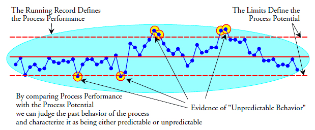

A process behavior chart makes no assumptions about your process or the data that characterize the product stream. It simply lets the data define both the generic process potential and the actual process performance. It then combines these two in a single graph to allow the user to characterize the process as behaving either predictably or unpredictably.
Figure 5: We characterize a process by comparing performance with potential
Since the group of uncontrolled factors are the source of the variation in the product stream, this characterization of the process behavior tells us something about the group of uncontrolled factors.

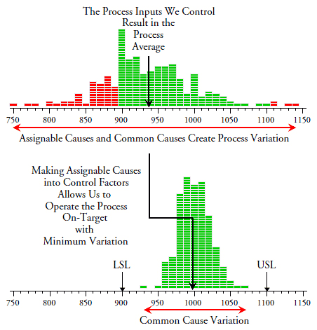

If the process shows evidence of unpredictable operation we think of the group of uncontrolled factors as containing one or more cause-and-effect relationships whose dominant effects show up above and beyond the background of the routine variation. The causes with these dominant effects are called assignable causes of exceptional variation.
Here the process is offering strong evidence that uncontrolled inputs with dominant effects exist. When a process is operated unpredictably it is being operated at less than its full potential. It will not have minimum variance, and it will not be operated economically. When assignable causes of exceptional variation are present it will almost always be economical to identify these process inputs and make them part of the set of control factors.
This is a high payback strategy for two reasons. When we make an assignable cause part of the group of control factors we not only gain an additional lever to use in adjusting the process average, but we also remove a large chunk of variation from the product stream. In this way, even though the process may have been unpredictable in the past, we learn how to improve the process and come closer to operating it predictably and on-target in the future.
