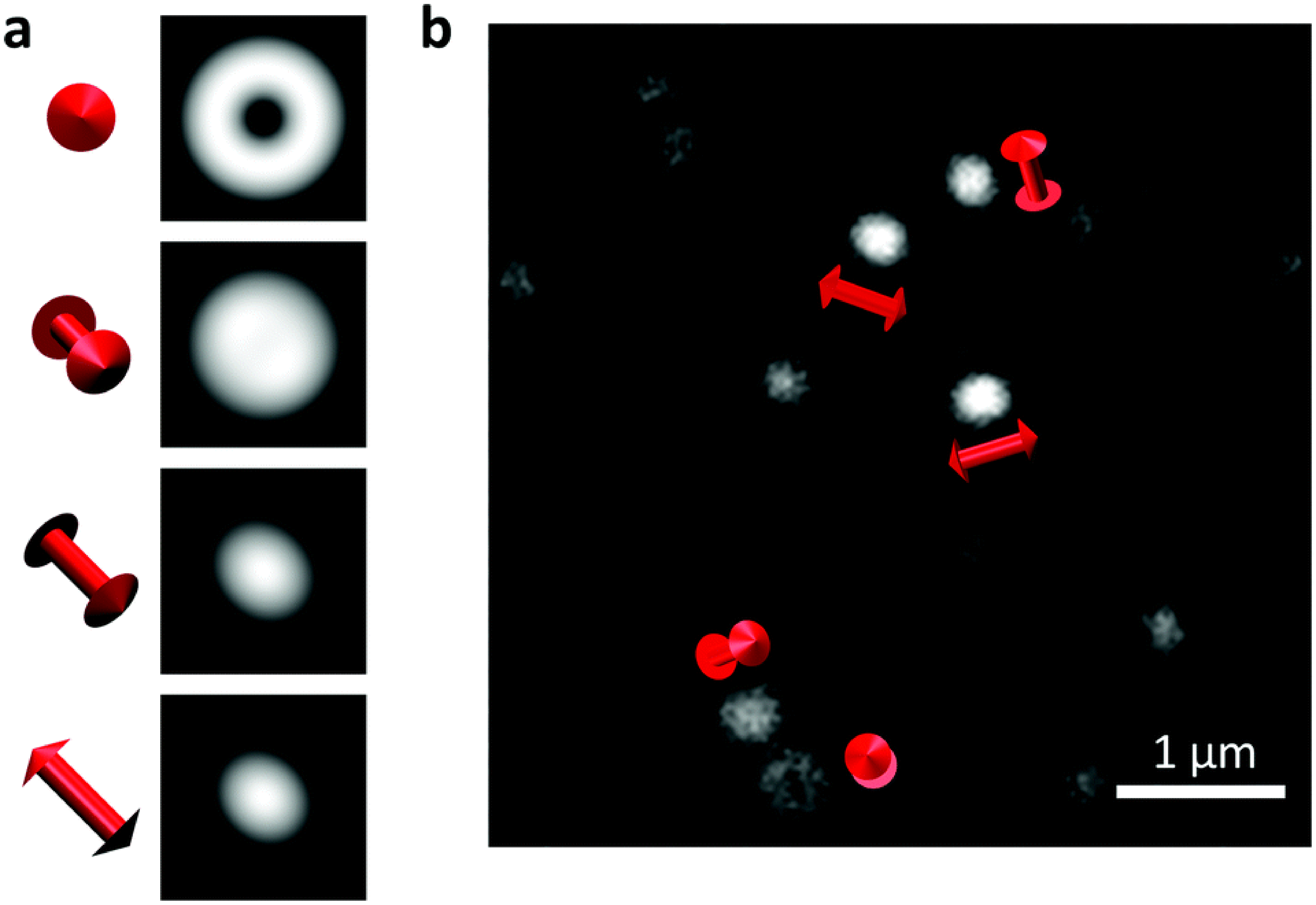

moleculesResearchers compared calculated images of single molecules in different orientations (left) with experimental ones (right) to determine the 3D alignment of the fluorescent molecules in a sample. 1 µm is one micrometer, about 1/100th the width of a human hair. Credit: NIST
The technique uses single-molecule, super-resolution optical microscopy, which can resolve objects in the range of 20 nanometers (billionths of a meter)—about one-tenth the size of what can be seen at the sharpest focus with a conventional optical microscope. The new method examines a polymer doped with fluorescent molecules that emit light of one wavelength when they are illuminated with light of another wavelength. An image of the emitted light reveals not only a molecule’s location, but also its orientation horizontally and vertically.

For many such materials, it is difficult to see the early onset of damage because there are no visible markers to track its effects. To provide those markers in their experiment, the researchers used a very thin film of a polymer found in Lucite and Plexiglas that had been doped with thousands of fluorescent molecules. Initially, the polymer was unstressed, and the embedded fluorescent molecules were in completely random orientations in three dimensions. Then the scientists applied force to the polymer, deforming it in a controlled, specific direction. As the polymer was strained, the embedded fluorescent molecules were carried along with the deformation, losing their random orientation and lining up with the path of the damage. That path was made visible by observing the pattern of emitted light from the embedded fluorescent molecules, which acted like a series of little flashlights pointing the way.
Prior to the experiment, the scientists used a mathematical model that predicted how light would look when emitted by molecules in different 3D alignments. When they illuminated the fluorescent molecules and made images of the emitted light, the results matched the model. After about 10,000 cycles of illumination, a telltale pattern emerged showing the extent of deformation.
